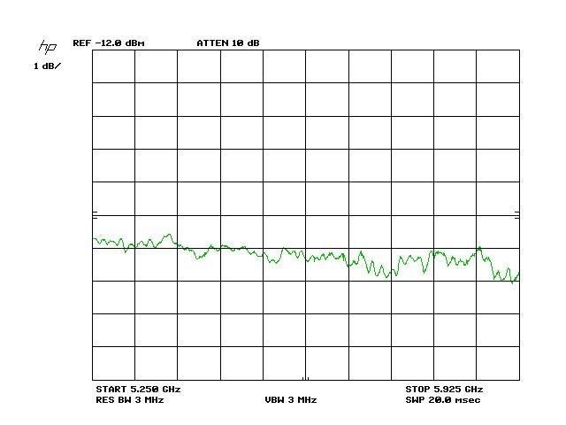

Poynting K-GRID-003-06
Frequency Response
